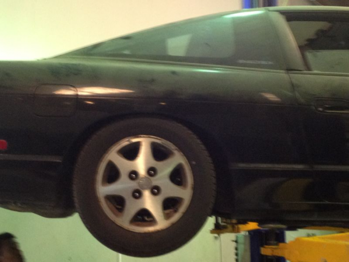

2- if u refer to the pic of the car jacked up in the air , is that normal for the competition coilovers ? Shouldn't they drop if the car is raised? The front ones are dropped the rear are as you see in the pic

the rear looks right there is much much less travel in coilovers over stock. so this looks normal.. with the knucle mod and the front you really want to run stock ish caster. this will cause a much flatter contact patch at full lock allowing more control up front. so you can stay on throtle and not hat the front end push....

2. did you set your ride height yet in they picture? S13 rear dampers are much shorter stroke than the front.
