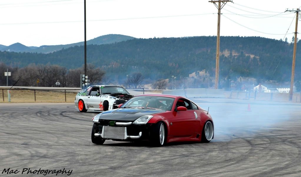

Look at tires. Barley make contact.
I suck when it comes to tuning my suspension
Hollywood
Thu Jun 27 2013, 04:44pm
Registered Member #708
Joined: Sun Feb 28 2010, 07:22pm
Posts: 653
you need to space out the front man. parts shot max makes rad wheel spacers. this will kill all your under steer whoes. and here is a photo of kado's car with the same situation so you know your not the only one.
Hollywood
Thu Jun 27 2013, 04:46pm
Posts: 653
oh also what is your tire size setup front and rear and what psi are you running in them ?
Zach711f
Thu Jun 27 2013, 07:18pm
Registered Member #3144
Joined: Wed Nov 07 2012, 04:00pm
Posts: 36
In the picture I'm running different than normal. In the front I usually use an 18x10 +12 offset and a 18x12 +20 in the rear. 255 35 18 front 265-275 35 18 rear 43 psi. Adjusted track width to .25" on each side running 5 degrees of camber. I forget the rest...oh yah -10 caster.
